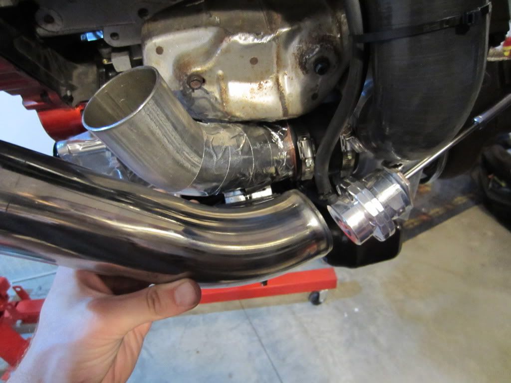

In Reply To what heat shield? looks like your coupler touches the posted by evan_aggie on August 16, 2011 at 07:57 AM

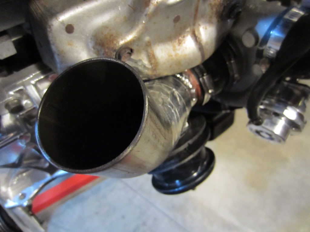

Message Heat shields fit (after little modification and lots of F words). No couplers touch the shields.
These are the only pics I could find. Everything was fit to clear, and everything wrapped.
The single bend pipe is sweet for a car without AC. Tried many times to make it work, but was never really happy with it, so I ended up having Spence weld up a new one out of a couple 45 bends I had laying around. Two bends is the best way to go with a 2.5 inlet. We got a single bend pipe to work on the passenger side, but will most likely weld up a similar two-bend pipe for better clearance of heat shield and PS pump.
